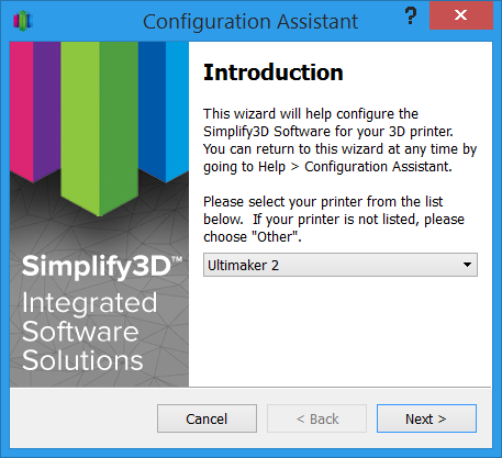

When you run Simplify3D for the first time, it will open the Configuration Assistant. Simply choose Ultimaker 2 from the drop down list and click ‘Next’ (the Configuration Assistant can be accessed at any time by going to Help > Configuration Assistant). Your software is now fully configured and we can advance to our workflow!
