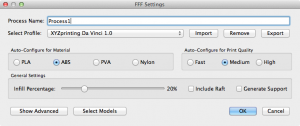

The main interface window is where you will import STL files and prepare the G-Code instructions required for printing. A Quick Start Guide is included with each software installation to help illustrate the process of preparing an individual model for printing. This guide can be accessed by going to Help > Quick Start Guide. As you work through the guide, you will import an STL file, position it on the build table, and add a FFF process that will determine how that model is printed (FFF stands for Fused Filament Fabrication and is the industry term for 3D printing). The settings for each FFF process play a large role in the quality of the final printed object. To make things simpler for our users, the software already includes a profile that has been specifically configured for the M2. You can load this profile by selecting it from the drop down list in the FFF Settings window. At this point, you should be ready to follow the remainder of the Quick Start Guide to begin printing on your new M2.
The MakerGear M2 is also equipped with an SD card reader and we would strongly suggest copying your large G-Code files directly to the SD card. Simply unplug the card and insert it into your computer to copy the files. The Marlin firmware requires the use of the 8.3 naming convention, so the filenames on the SD card can only have up to 8 uppercase characters for the filename and up to 3 uppercase characters for the file extension. For example, “3D_Knot_for_M2.gcode” would need to be renamed to something like “M2KNOT.G” when placed on the SD card. Once you have plugged the card back into your M2, you can use the “Print from SD Card” button in the Machine Control Panel to begin the print. This is particularly useful for large parts so that you do not need to have your computer attached and awake for the entire print. It also offers a much lower latency that USB serial protocols which allows for better print quality.
