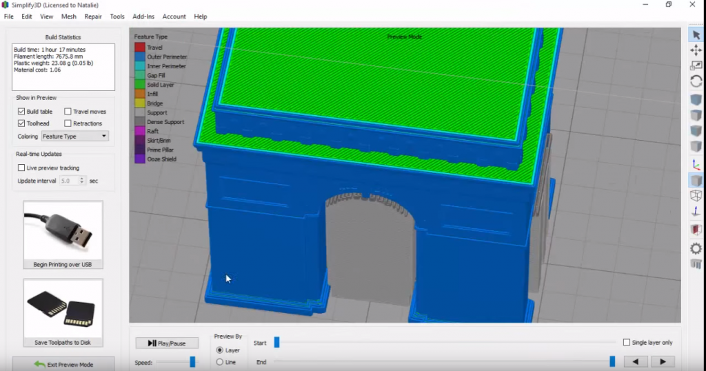

Let’s take a look at how to add supports to this Hulk piggy bank model. Simplify3D makes this easy: Just open the process settings and click the checkbox next to Generate Support. When you do this, the software will automatically add supports to the selected model based on the stock settings from your printer profile. Let’s generate a preview to see how these supports will be constructed. Also, let’s change the preview coloring to Feature Type, which will show us each component of our print in a different color. Here the support structures are gray. So with one click, you’ve got supports and you’d be ready to go. But one of the great features of Simplify3D is that you are able to fully customize your support structures.
